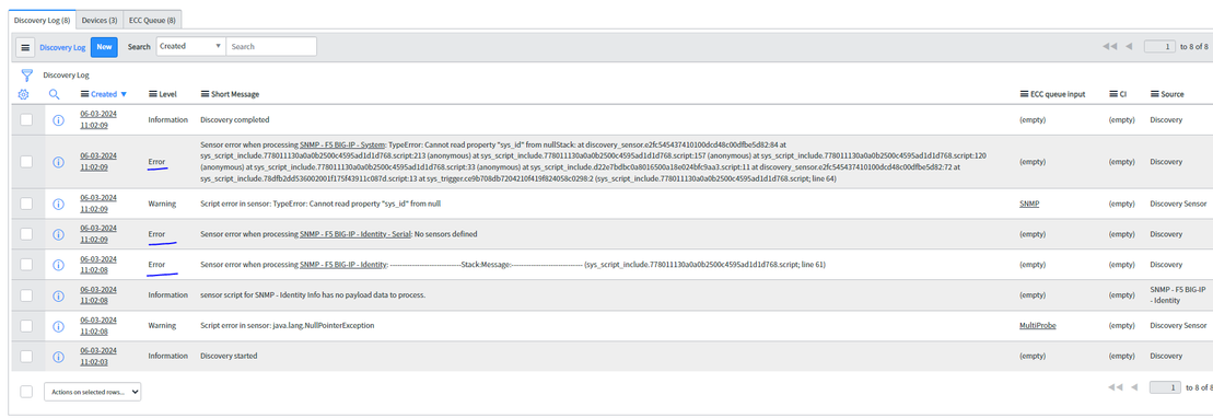

Dear Discovery Experts !
Any idea what can be the root cause for this error ?
1. Iam using OOTB Probes and sensors for F5 (Which are OOTB - system ,serial and identity).
2. Iam not using OOTB snmp port probe > Rater Created a custom port probe snmp_f5 which triggers all F5 probes (seiral, system & identity).
3. Using Behaviour in schedule to trigger my custom port probe.
4. 161 is open , creds test is successful.
5. OID are added to the oid table. (Iam receiving 1 oid from serial probe and 225 oid from system probe). but unable to process the payload and resulting in above error...
Need your assistance in finding the root cause.
