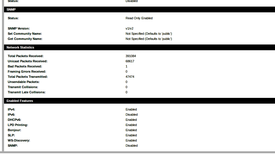

First of all check whether your SNMP device is enabled or not?
If not enable it, ask network administrator to enable that device, then do the discovery.
To check whether the selected SNMP device is enabled or disabled, just type the IP in any browser. ex if it is a printer
you'll see a network summary page for of your printer displaying the printer model name. Select Home tab and goto Network summary.
Down in the Enabled features block check the SNMP : Enabled or Disabled, mine is disabled from the below image you can see. snmp.png
