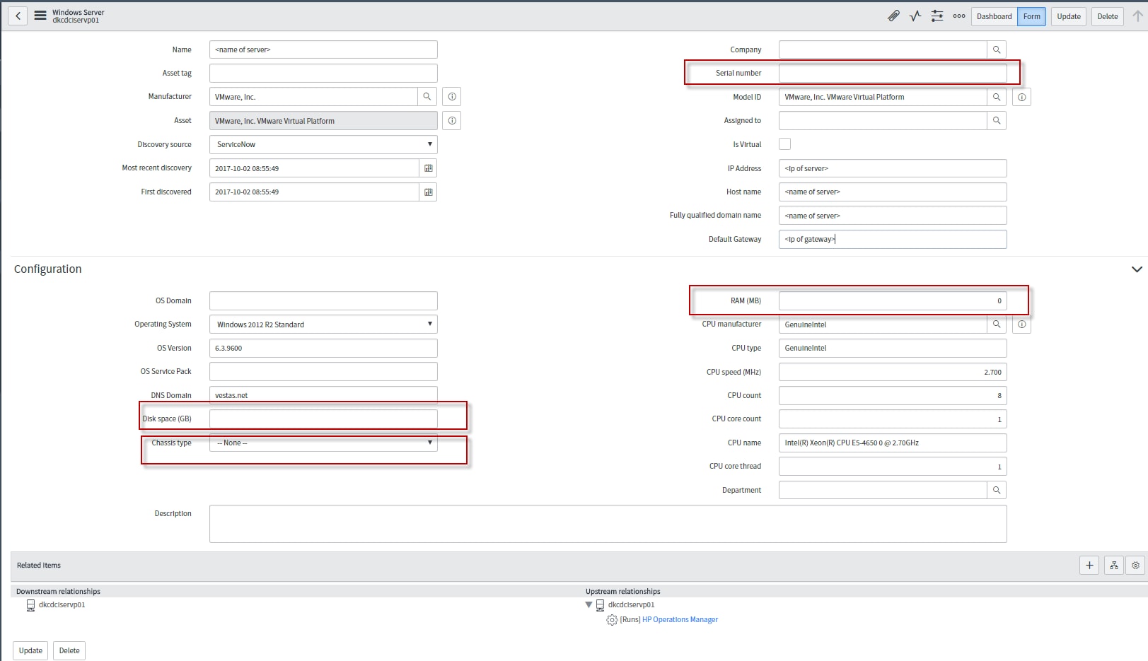

However, I get some errors:
Looking at the created CIs these errors seem to have something to do with missing information about 'Serial Number', 'RAM', 'Disk space (GB) and 'Chassis type':
And missing information about 'Storage Devices', 'File Systems', 'Serial Numbers', 'Memory Modules' and 'TCP Connections':
If I add the 'Mid456' user to 'Administrators' all these information are obtained and I don't see the 2 warning in the Discovery Status log.
