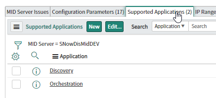

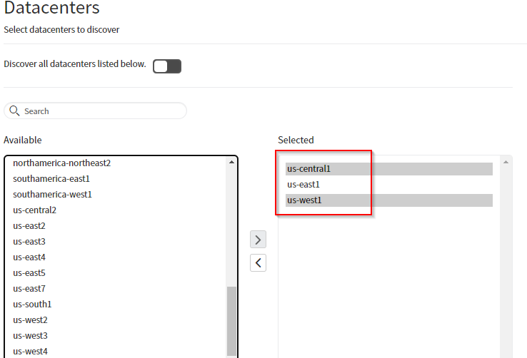

Please find the attached screenshots for the MID server capabilities and discovery manager setup.
Does the MID server set up should be inside the google cloud environment?
Thanks in advance!
SiD2
Hi @Ceasar,
MID need not be inside google cloud env.
