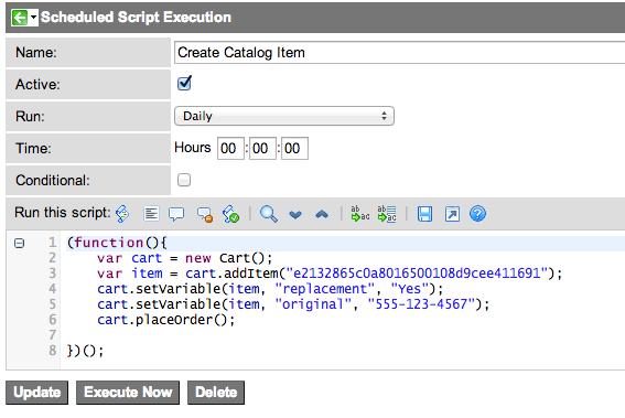

Your Scheduled Script Execution record should look similar to this:
Set your scheduling info and you are set.   Click on "Execute Now" to try it out.   This will create the Request and Requested Item records for you.   If you need some special scheduling conditions on the Scheduled Job, check out this post - Custom Discovery Schedule with a Condition Script

Jim thank you so much for your suggestion, I gave this a try and it was perfect!
Cannot thank you enough for your quick and extremely well written response.   Have a wicked day!
