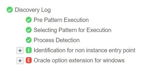

To add to Rahul Priyadarshy, the Oracle Database Discovery has 1) Basic Oracle Database Discovery and two additional capabilities 2) Oracle Options and 3) Extend Oracle Instance Extension.  Basic Oracle Database Discovery (#1) does not require new configurations, but Oracle Options (#2) and Extend Oracle Instance Extension (#3) requires additional configurations.  All 3 capabilities are built into the into the Oracle DB On Windows Pattern and update tables/attributes as listed below.
Oracle Database Discovery is enabled by default when the Horizontal Discovery plugin is enabled. Oracle Database Discovery by default does NOT log into the Oracle Database. The sequence of steps for Oracle Database Discovery:
  1. ServiceNow Discovery discovers a Windows Server.
  2. During the Windows server discovery, the Windows - Application Dependency Mapping probe runs. An Oracle instance is detected, and oracle.exe is returned in the input payload of the Probe.
  3. The Oracle Instance Process Classifier (Discovery Definition->CI Classification->Processes) is launched based on finding the oracle.exe from step 2.
  4. The Oracle Instance Process Classifier launches the Oracle DB On Windows Pattern. The pattern creates a new entry in the Oracle Instances [cmdb_ci_db_ora_instance] table and CI Relationship [cmdb_rel_ci] table.
Note:  In the Oracle DB On Windows pattern log, the first 4 sections are part of Basic Oracle Database Discovery. The sections Oracle option extension for windows and Extend Oracle Instance will not run without additional configurations and the following error shows in the logs:  Applicative credentials for CI type cmdb_ci_db_ora_instance are not defined. Please go to the Credentials page to add the appropriate Applicative Credentials.

  2. With the added configurations, the Oracle DB On Windows Pattern executes the steps in the Oracle option extension for windows section. The data returned will be populated in the Oracle Options [samp_oracle_options] table.
Note: The Oracle option extension for windows will show green for a successful execution.
