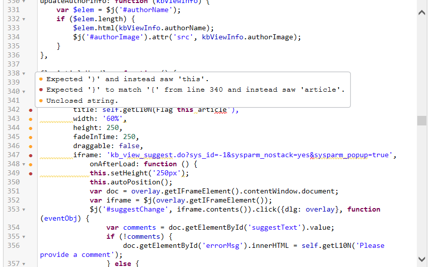

I had a request to change the Flag Article button to Report Article within knowledge Base articles, after reading around in the ServiceNow community, I located that this can be done by editing the UI Script — KBViewArticle, However with my JavaScri
clivebushell
Giga Contributor
KBViewArticle
However with my JavaScript skills being zero the code now
seems to have a problem, causing the top four icons to no longer work on
knowledge base articles, please could you take a look and offer any help?
Many thanks

Hi Chuck,
Thanks for your reply, just added a screenshot of the JS.
I am trying to rename the Flag article button to Report article
Kind regards
Clive

Hi Chuck,
Before I try and rename the button again, I need help to try and get the buttons on the KB Article pages working again, at the moment you click and nothing happens
  I'm guessing its to do with this?
  Kind regards
Clive
