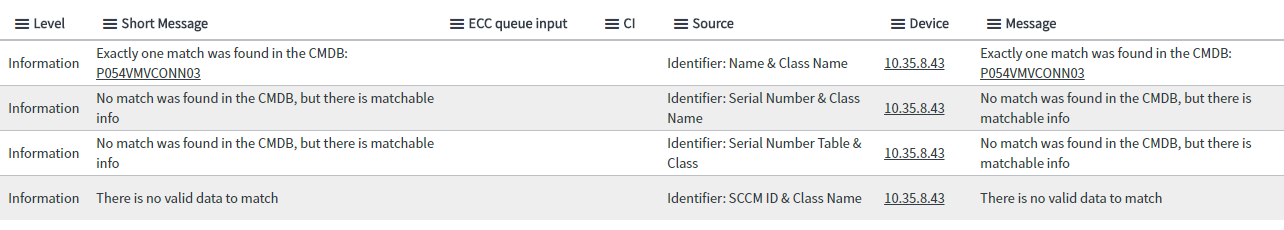

When reviewing discovery logs, we see the following:
So, we can see that it is using the name, rather than the Serial Number from the logs.
The first rule for SCCM ID & class name is ignored, as expected.
The second Identifier Rule "Serial Number Table & Class" has multiple records in the Serial Number table (cmdb_serial_number).   There are multiple records for the same SN# with different types and different SN# for the same CI.   Unsure how this happened, but it is there.   I understand the message here, and while I'd like to understand more about how stuff gets in this table and such, at least the message makes sense.
The third identifier Rule "Serial Number and Class Name" is based solely on the cmdb_hardware table.   Doing a search on the serial numbers, I find a single record for 1 serial number and no matching records for the other 2 records.
It then uses the 4th Identifier rule of name, to get the match.
