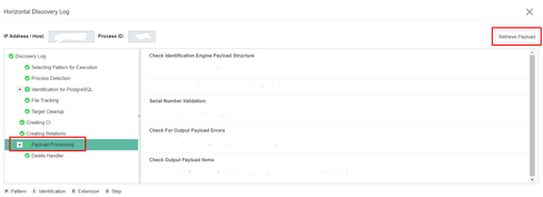

I'm facing a problem while discovering a Nutanix Prism,
It discovers the prism well, but the discovery does not succeed because of an error in the payload
I was wondering if anyone has already encountered a similar error
The error source is com.glide.ui.ServletErrorListener according to the logs

Servicenow have never been able to solve this problem. As far as I'm concerned, the error message I was getting wasn't the real problem.
Try to retrieve the payload directly from here:
then simulate it on the identification simulation module :
you'll see more clearly what's going on.
In my case, it was a duplicated item in the payload that was preventing CI creation/update, so I had to add a deduplication step to the payload to solve the problem.
