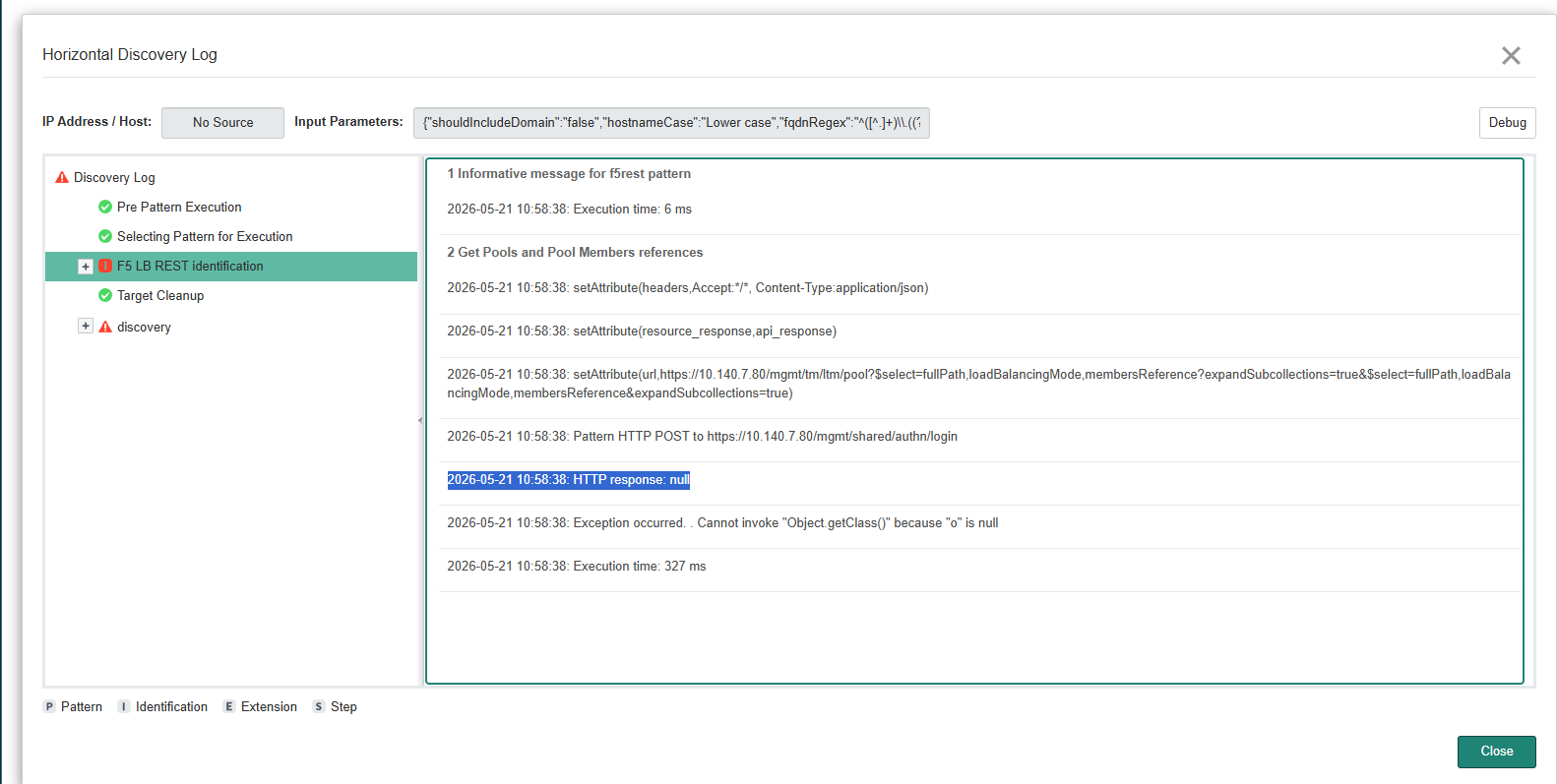

Discovery fails at the authentication step with "HTTP response: null".

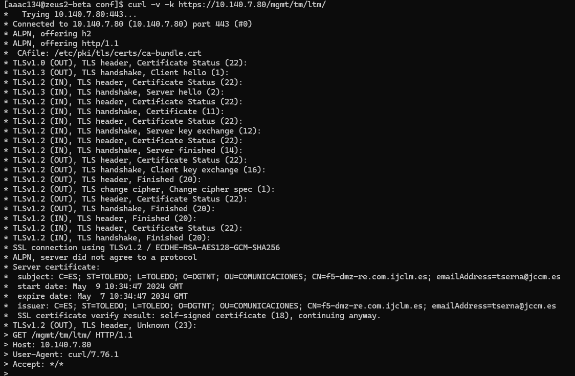

OS-level connectivity: I verified that the MID Server host can successfully reach the F5 API using curl. It returns a 401 Unauthorized, confirming the network path is open and there is no firewall block.
The "Null" issue: ServiceNow Discovery logs consistently show "HTTP response: null" followed by an exception (Cannot invoke "Object.getClass()" because "o" is null). It seems the Java process is struggling to route traffic through the proxy for this specific endpoint.
Attempted mitigations: I tried configuring no_proxy (systemd/wrapper), but the MID Server ignores these overrides.
