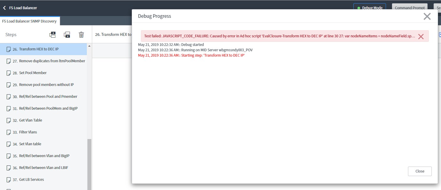

I am trying to discover a F5 Load Balancer but I am getting this error "Failed Exploring CI Pattern, Pattern name: F5 Load Balancer, To Check Pattern Log Press Here". It failed at the "Transform HEX to DEC IP". Discovery failed and it wasn't able to finish the identification process, therefore, CI not created. Help!!
2019-05-20 14:12:20: JAVASCRIPT_CODE_FAILURE: Caused by error in Ad hoc script 'EvalClosure-Transform HEX to DEC IP' at line 30
27: var nodeNameItems = nodeNameField.split("/");
28: var nodeName = nodeNameItems[nodeNameItems.length-1];
29: if ( nodeName != null && nodeName.trim() != "" ){
==> 30: rtrn = Packages.com.snc.sw.util.DNSUtils.resolveToOneIP(nodeName);
31: }
32: }
33: else
Check Processing Success
2019-05-20 11:12:25: Identification Engine: Discovery status is FAILURE, unable to get error message.

I would start by putting the pattern into debug mode and walking it through for that F5 Load Blanacer. Go to the step where it's transforming hex to dec IP and look at what is in nodeName variable as there could be invalid data. If this is the case your next step will be to backtrack before this and see where it's getting that from. Let me know how it goes.

I recently saw the same issue, and thought I would update this post with the solution that worked.
The issue was with this particular function:
If the DNS fails or doesn't resolve for one of the nodes, then the whole script execution will fail. I was able to resolve the issue by wrapping this around a try, catch statement.
Here is a similar example with Azure Website pattern:
https://hi.service-now.com/kb_view.do?sysparm_article=KB0829236
