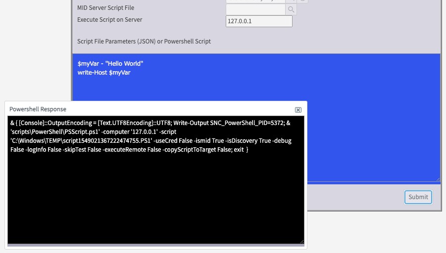

Once you get there, you will be present with the GUI PowerShell utility. Enter in a valid, running, MID Server. Then type in the remote Windows device IP Address that will execute your PowerShell script. The IP Address of 127.0.0.1 tells the MID Server to execute the script on the same box that is hosting the MID Server.
This first example shows how to execute a PowerShell script
This second example shows how to execute the demo MID Script file with the paramets
Once you click the "Submit" button. The utility will wait for the response to complete and then it will pop up a dialog box with the result and any errors.

I am getting the following:
& { [Console]::OutputEncoding = [Text.UTF8Encoding]::UTF8; Write-Output SNC_PowerShell_PID=6232; & 'scripts\PowerShell\PSScript.ps1' -computer '' -script 'C:\Windows\TEMP\script4481333714117765786.PS1' -useCred False -ismid False -isDiscovery True -debug False -logInfo False -skipTest False -executeRemote False -copyScriptToTarget False; exit }
