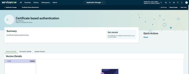

A 200 OK confirms TLS support at the load balancer. Also confirm the plugin is active:
If either check fails, stop here and engage ServiceNow Support, mutual auth for MID connections is enabled at the infrastructure level and isn't something you can toggle from the instance UI.

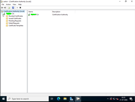

Step 2 - Build the internal CA
For an internal deployment, an Enterprise Root CA via AD Certificate Services is the simplest path. On the Domain Controller:

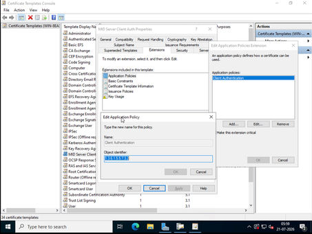

Duplicate the built-in Workstation Authentication template — never edit the built-in ones directly. Name it something like MIDServerClientAuth.
Two settings actually matter:
Extensions tab confirm Client Authentication is present under Application Policies.

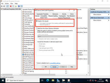

Subject Name tab , change this from "Build from this Active Directory information" to "Supply in the request."
This second one is the mistake that catches almost everyone. If you leave it on "Build from AD," the CA silently overwrites whatever Subject you specify in your CSR with the requesting computer's AD identity. You'll end up with a certificate whose Subject is your server's hostname instead of something like CN=MID Server mTLS Client — and since ServiceNow maps the certificate to a user based on Subject, your user mapping breaks in a way that's very non-obvious to debug from the symptoms alone.

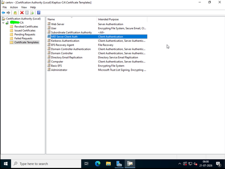

Publish the template (New → Certificate Template to Issue) and confirm it's listed:
