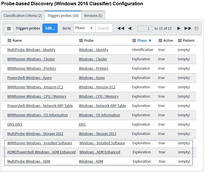

As Andrew mentioned, depending on the type of discovery (Probe-based or Pattern-based) requires setting the Active flag on the probe. Instead of having a tab for Probe-based discovery and a tab for Pattern-based discovery, both are grouped together in the Triggers probes tab.
To clearly separate out the difference between the two types of discovery, the following is a Windows 2016 Server Classifier configuration for Pattern-based discovery.
And a Windows 2016 Server Classifier configuration for Probe-based discovery.
Note: The probes grouped together in purple are functionality that didn’t get incorporated into the Windows OS – Servers pattern and the active attribute is set to true for both Probe-based and Pattern-based discovery.
