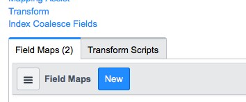

5. At the bottom left, in the Field Maps tab/list, create a new field map
Create a new mapping from your target import table to your sys_ field that you want to update
6. Save, upload your data, and run your transform.
