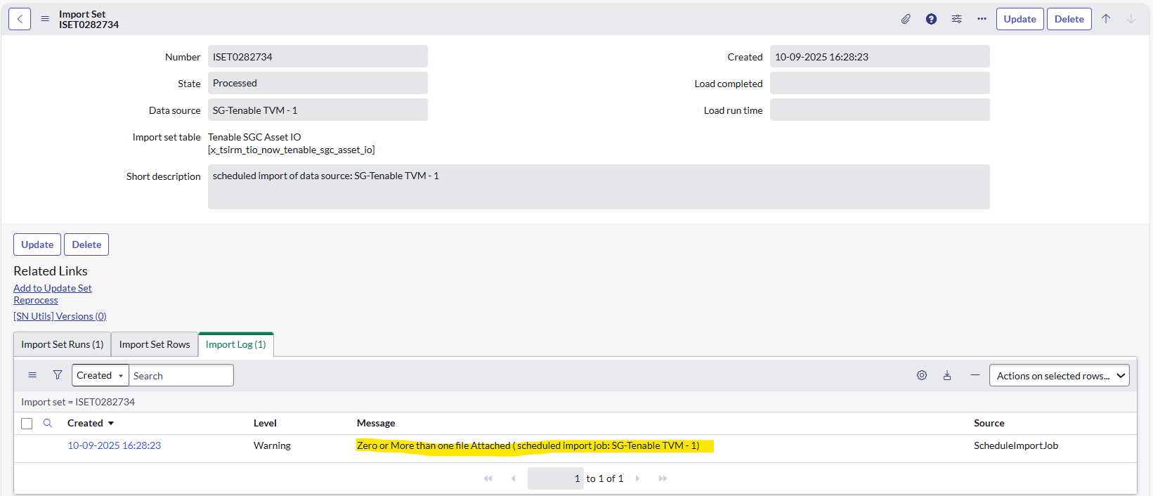

We’ve installed the Service Graph Connector for Tenable(x_tsirm_tio_now) to bring assets into the CMDB from Tenable. The connector setup was successful, and we received a 200 OK(success) response when testing the connection.
The connector includes multiple data sources mapped to scheduled import jobs. One of the data sources, 'SG-Tenable TVM - 1', uses the "Attachment" method to retrieve files.
However, when we attempt a test load of 20 records from the related list of this data source, we receive the following error:
com.glide.db.impex.datasource.DataSourceException: Zero or More than one file Attached
I’ve attached screenshots of:
  • Import Status
  • Application Logs
  • Data Source
Has anyone encountered this issue before? What could be causing it, and how can we resolve it?

I agree, In the setup for the Service Graph Connector for Tenable, the data source SG-Tenable TVM - 1 uses the "Attachment" method to retrieve files.
Since we hadn’t executed the scheduled jobs earlier, no REST API calls were made to Tenable, and therefore no JSON files were retrieved or attached to the data source. This explains the error during the test load:
It seems the data source expects a file to be attached for the import set to execute properly.
I’ve now run the scheduled job, which should have invoked the Script Include, made the REST API call to Tenable, fetched the data, and attached the file to the data source. However, I’m still seeing the same error in the import set. Please check attached screenshot.
Let me know if there’s anything else I should check or configure.
Best regards,
Prasad
@PrasadShelar  As per your explanation and error screen shot, it shows that the REST API/Flow action/ Data stream is not working properly. This should be responsible for getting an attachment and attaching it to Data source.
You can go to Workflow Studio and check Flow Action or Data stream (each SG has a different way, like SG-Azure works with Flow Action, whereas, SG-SolarWinds works with DataStream). There is an option to test them and check if the attachment is fetched. As the authontication was successful, the connection errors should be there.
To my knowledge, there is nothing much in configuration to be done. But there is debug needs to be done why the attachment is not fetched.
