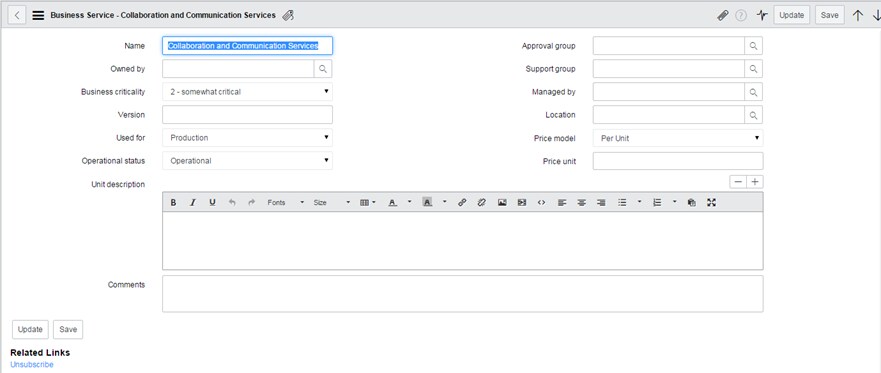

  1. Create the Business Service:

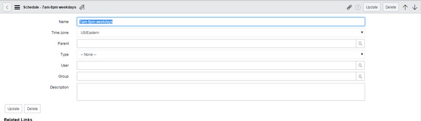

4.   Add the Schedule:
5.   Add the Schedule entries:

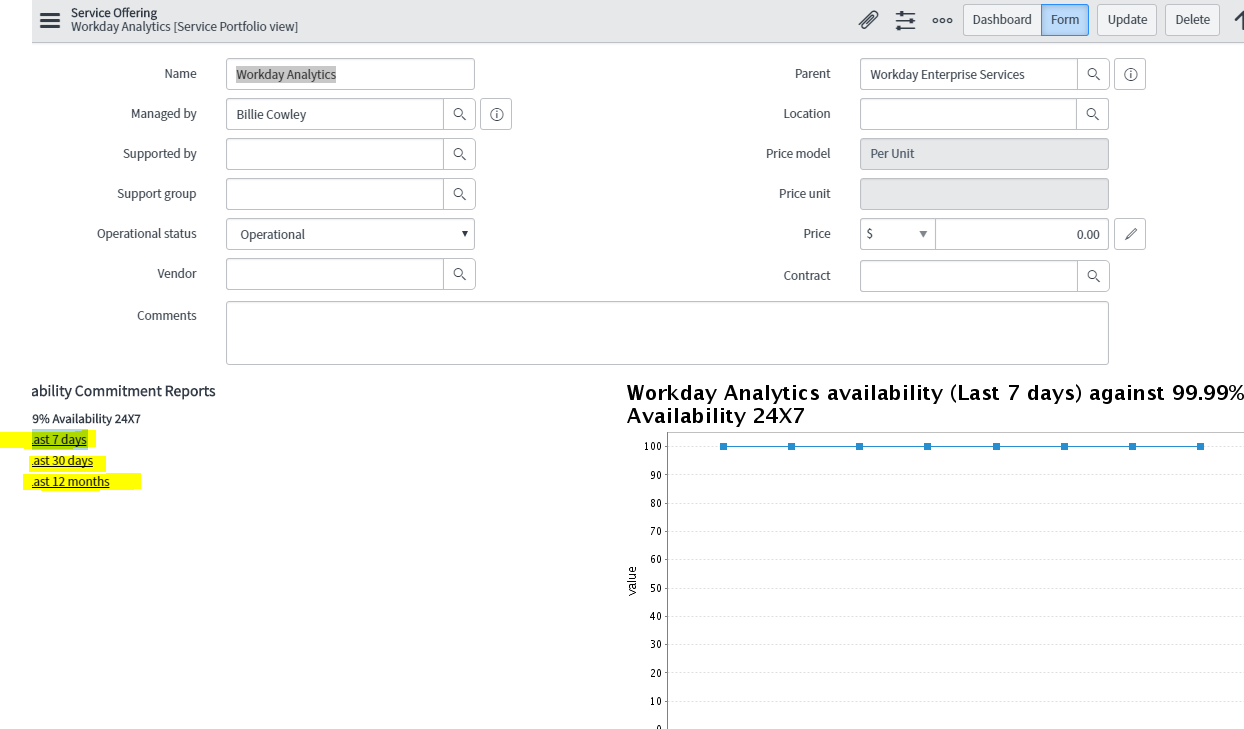

Hi Jean,
Thank you for the screen prints and instructions.   We are currently using Geneva, and on the form to create a Service Offering, I have a Parent field, not a Parent(s) field and am limited to entering only one Parent.
Is there some other setting that needs to be set up to be able to add multiple Parents?
Thank You again,
James
Hi. i want to configure these ones marked with yellow. For example dates for may april march as following.How i can configure those ones
