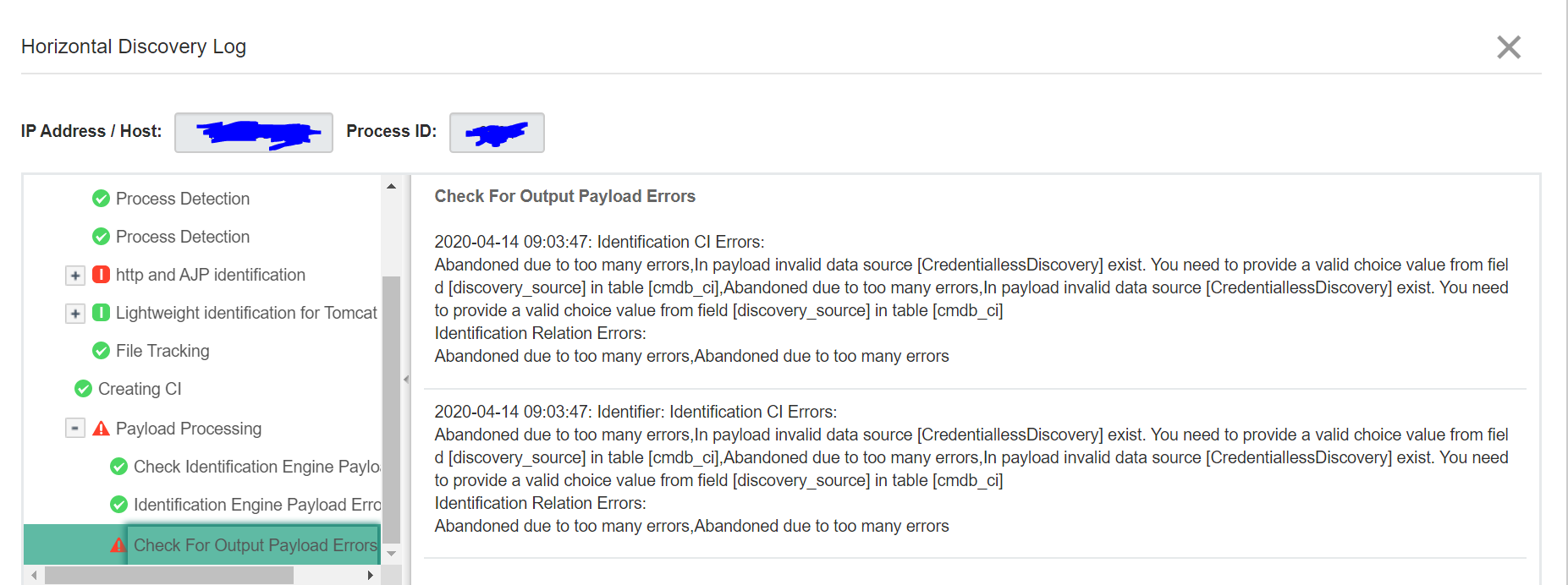

I'm also facing the similar issue but with the Docker pattern, Delivery controller and Tomcat aswell ...?
Reference link: https://community.servicenow.com/community?id=community_question&sys_id=eb3da90fdb5167c0f21f5583ca96...
Can any one help me out.
I'm attaching the screen shots of the pattern and the error from the docker pattern logs and Tomcat pattern logs.
while debugging the patterns it's showing the common error for most of them
Process detection failed: Check that the process is running on the host, verify the CI has a Running process on this port, and check the process strategy for the pattern section is correct..

This is for Tomact error. You dont have valid choice value in discovery source field.
https://hi.service-now.com/kb_view.do?sysparm_article=KB0725092

Thanks for your response Ashutosh.
I verified the discovery source ----- it's set as Servicenow only. But before this payload processing error. our pattern (Tomcat/ Docker/ Delivery controller) is failing at the process id match step and Identification phase only
Any suggestions/ outputs for this issue..?
