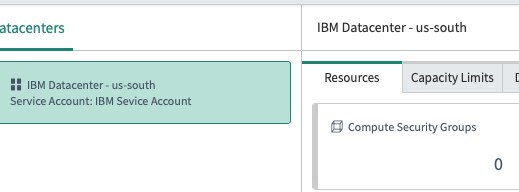

Vivektietsood
thanks. Please let me know how to increase the wait_time_ minutes. Is this at SNOW end ? I am not hopeful that it would still work as I created a specific credential for ServiceNow to use Terraform credentials. I then used these credentials to discover Terraform server (enterprise). After which I created a catalog entry using the discovered .tf files. Nowhere I instructed catalog entry to use IBM Service Account.
I created Service Account before starting this terraform project and was able to discover IBM data centersfind_real_file.png
