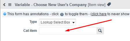

I have a form/item in the Service Catalog where I have a problem.
I am asking the user for their company but the variable is displayed twice. In the place where I want it, and at the end of the form.
There is only 1 variable and when i deactivate it, both fields on the form disappear.
Anyone who have experienced this and knows how to solve it?
I have tried deleting the variable and creating it again from scratch (with same name) and the error is still there.

Never mind. I solved it.
The original variable came from a Variable Set - and here I had made a relation between the variable and the category item. This seems to cause this problem.
