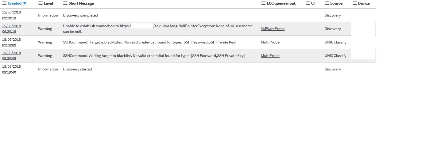

I have a problem discovering a particular vCenter. I have VMware credentials, and when I test these credentials against the vCenter they are successfully validated. But when I attempt discovery of the vCenter, it fails.
The input payload to the VMWareProbe contains these results:
error="Unable to establish connection to https://xx.xx.xx.xx/sdk: java.lang.NullPointerException: None of url, username can be null." probe_time="6345" result_code="900000"
