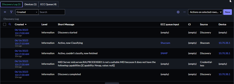

I'm looking for knowledge on discovering our VeloCloud VCE router correctly. I have a SNMPv3 creational that validates on the IP when testing. Im running a quick discovery on a single IP at the moment but it returns "Active, couldn't classify, now finished".
Ive added a lot of different OIDs from the payload to try and help with classifying but it still ends the same way. What am I doing wrong?

Does the sysoid come back in the snmp classify return? We need that to match to continue classification

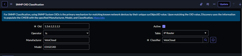

Ive tried creating OIDs in ServiceNow based on a few of these with no luck:

Currently I have this:

You arent pulling the SysOID back in the payload then there will be nothing to match in the snmp SysOID table, thus no classification.  What you are trying to do is use a OID 'question' (1.3.6.1.2.1.5) of name to match the return, SNMP SysOIDs dont work that way.
1. You can contact the manufacturer and have them help you understand why their systems do not reply to that OID query.
2. Add a different classification criteria in the router classifier or create your own that has something like sysdescr contains VeloCloud.  I show you how here and explain how to properly use the snmpsysOID table.
