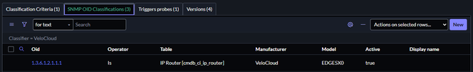

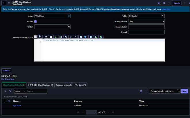

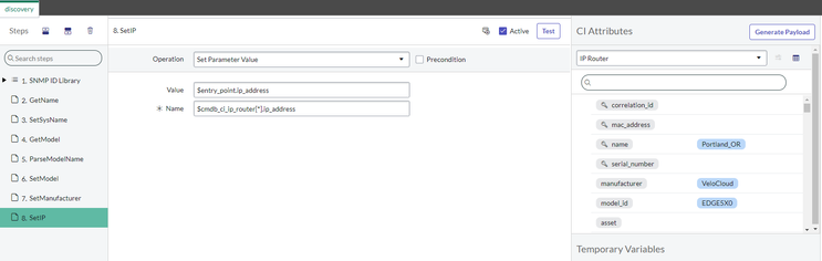

Thanks for the link. I followed your video on creating/mapping a pattern which seems to work in the Pattern Designer (see below) but during a quick discovery the IP still remains unclassified. Any tips for getting it to pull in?
Again, because you are trying to use a oid query as a response value in your sysoid...
I apologize for not comprehending this.
Am I to create a new SNMP Classification were the classification criteria is sysDescr contains VeloCloud and set the trigger probe to my newly created pattern?
Thanks again for being patient with me.
Robert
Yes, you can try that, it should work.
