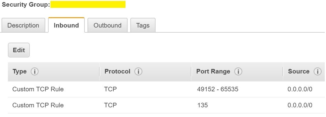

If you successfully test your credential outside of ServiceNow Discovery using RDP, then the next troubleshooting step would be to check the AWS Security Group between the MID Server and the Windows Server 2016.  For Windows, both port 135 and the high ports (49152 – 65535) need to be open in the AWS Security Group:find_real_file.png
