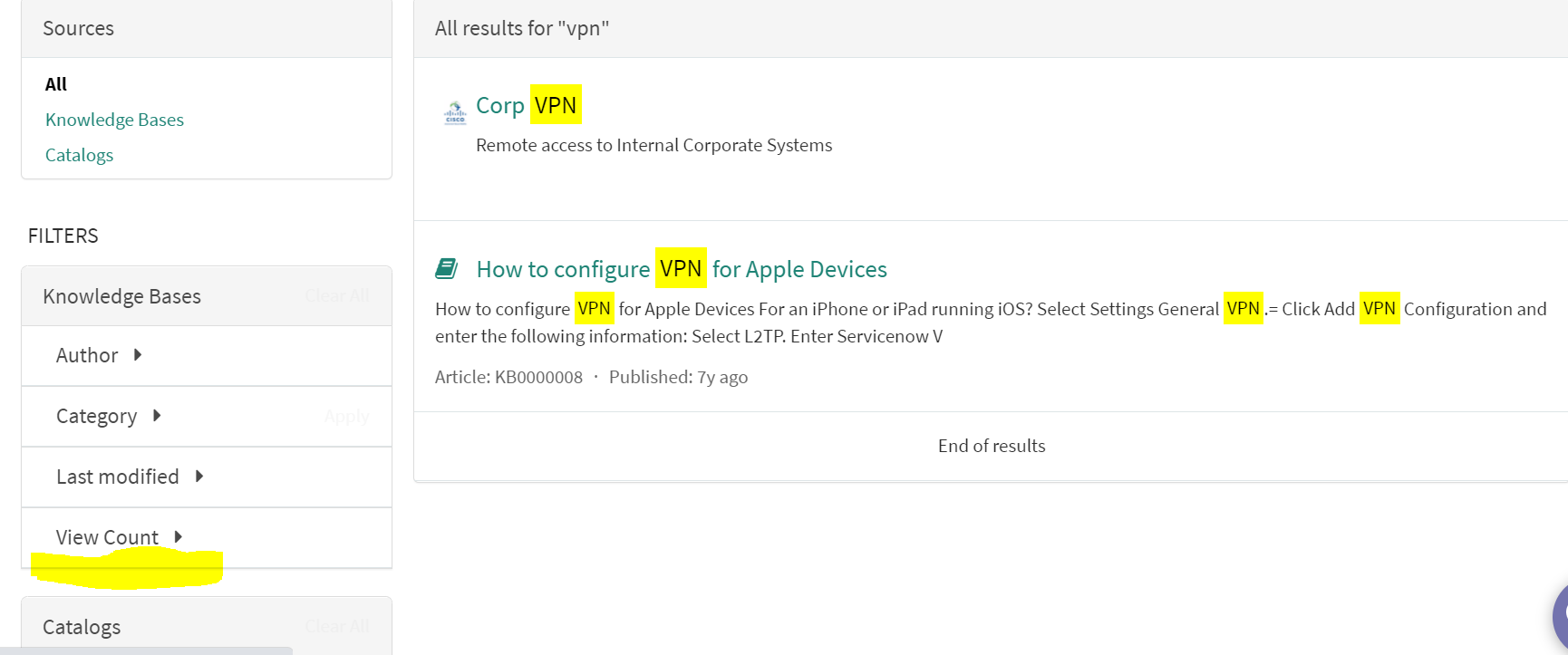

My requirement is to display the Knowledge Language Facet under View Count facet in sp_search page..
I have attached the screenshot for reference

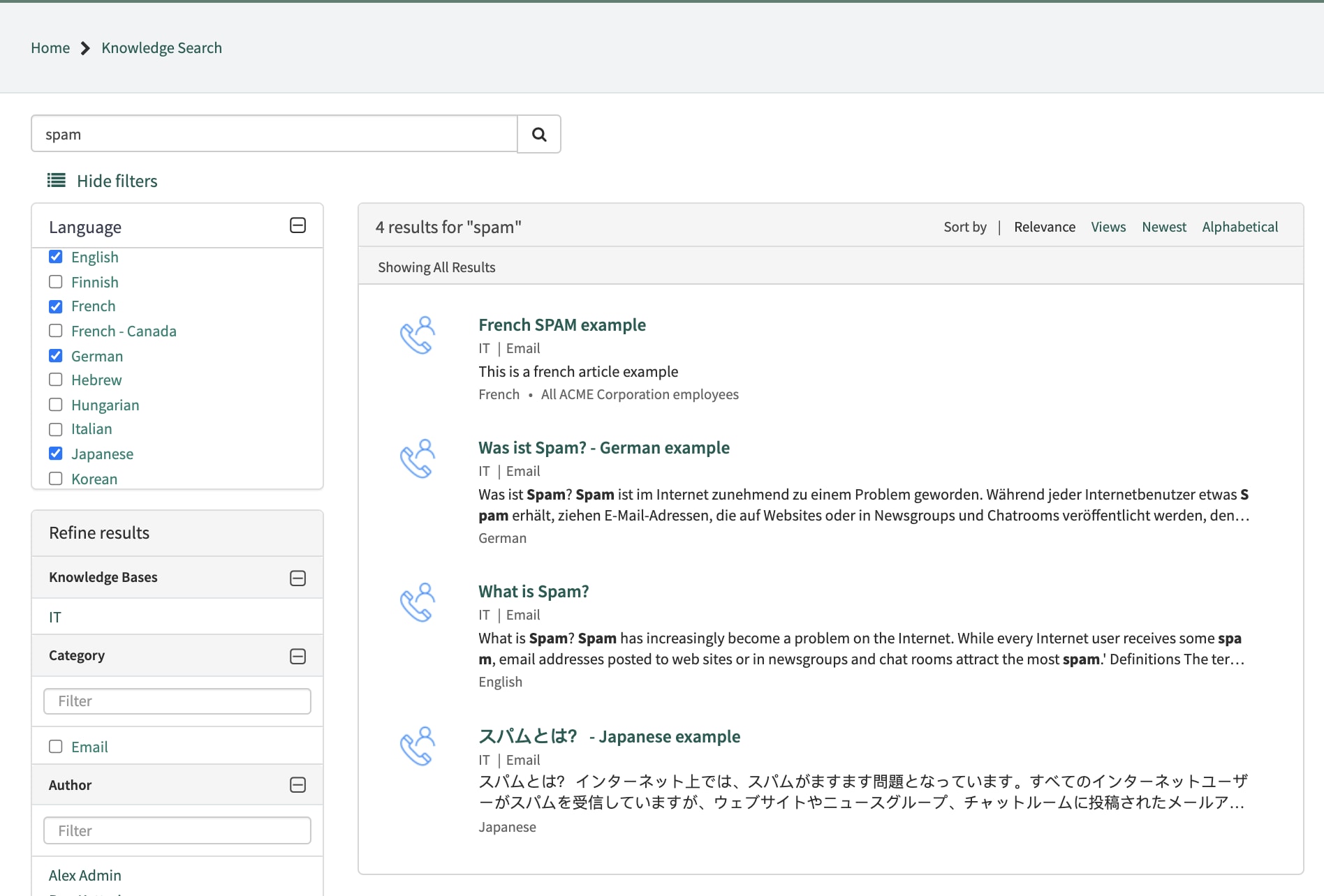

Ok, the standard search results page (making a guess from your screenshot) doesn't natively support language filtering. So you're best bet is to redirect your results to the results page from the /kb portal which natively has that capability (as detailed in the link in my previous post), then you can do filtering like this:

Thank you for your help on this. It works!!. However, I would need to place the Custom widget(Search within) inside the 'Faceted Search' widget. So that the end users know that there is a link to the kb_search page. Now, the custom widget is placed at the end of the page to its left-side.
First image shows the current view of the custom widget.
Need the custom widget to be placed in highlighted area(below Sources).
Would that be possible or how do we make it possible.
