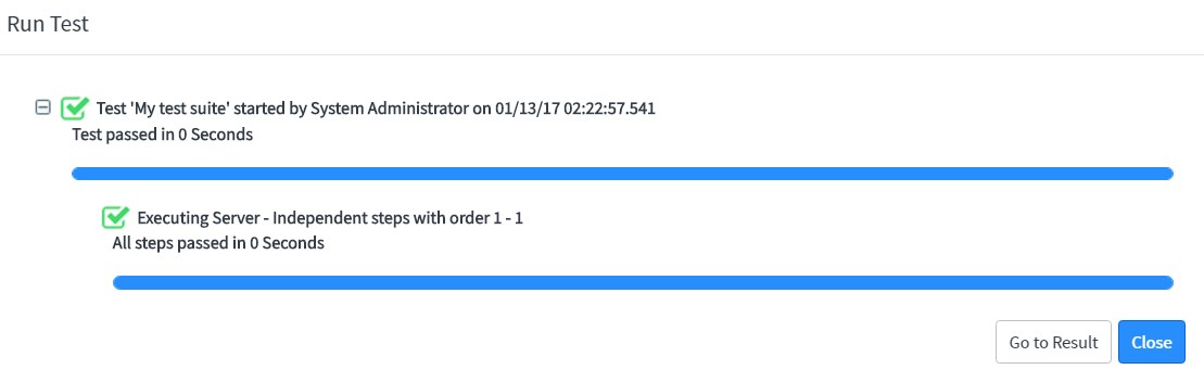

However, if I code my suite like the following (test failing in the middle instead of in the last place):

And run the test, SNow shadows the error status, although it properly registered the number of successful tests:
I am no Jasmine expert at all, but it seems to me like SNow is showing the final result of the suite based only on the last test placed in it. Could this be a bug in the brand-new SNow ATF or it is expected to use just one test per suite (one test for each registered SNow Test in ATF) to get a coherent status result? I don't know, but that wouldn't be very flexible, right?
