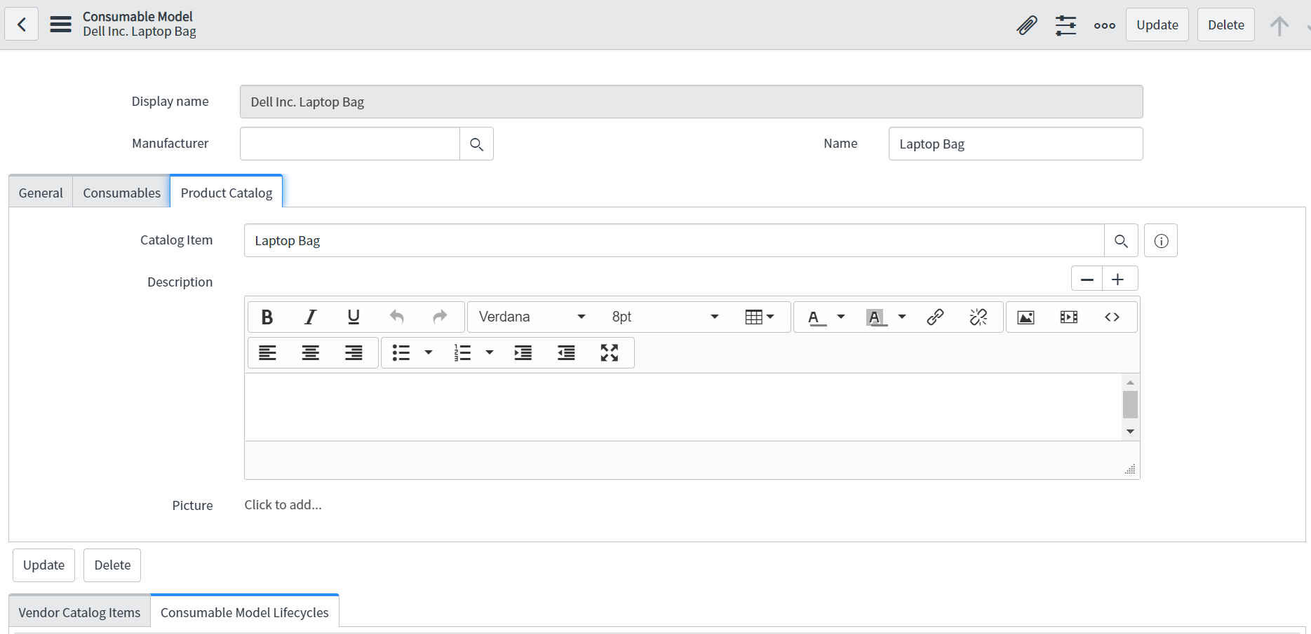

So I checked the consumable model and I see 'laptop bag' the item which am testing is available.
I have attached the screenshot, Can you check if something is missing or not tagged in the model or something I should change.
Rini
I got only one doubt Neha, Should I have to give 'alm_consumable' or just 'consumable'.
Because I see all the consumables stored in alm_consumable table.
Pardon my ignorance!
Rini
Yes, you should use  'alm_consumable', this is the table name.
