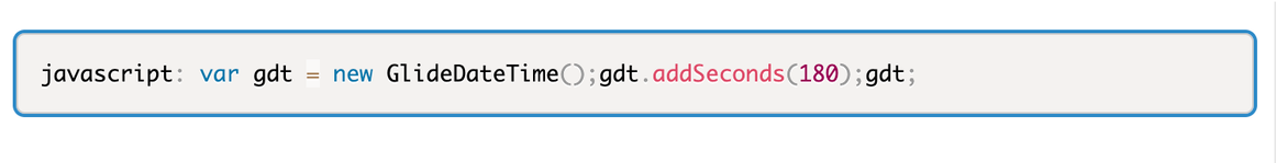

You can use the below to add 3 minutes for the current date time
javascript: var gdt = new GlideDateTime();gdt.addSeconds(180);gdt;

You can use GlideDateTime(). I tried with below and it works for me to set Begin date as same as the running time and End as begin date + 900 seconds . You can set 120 or 180 seconds to set the end date to 2 0r 3 minutes after the current time respectively
Set begin -- javascript:new GlideDateTime();
end -- javascript:var gdt = new GlideDateTime();gdt.addSeconds(180);gdt;
