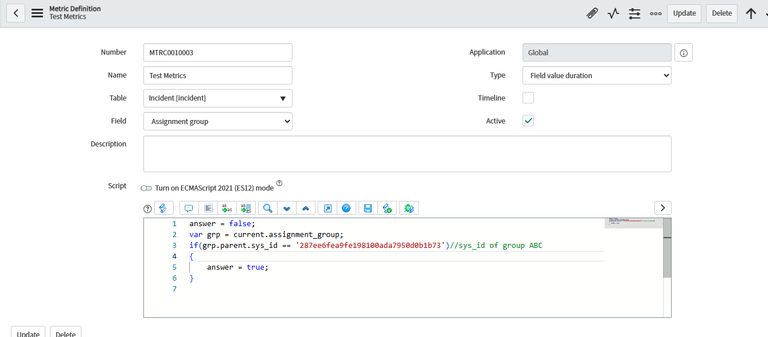

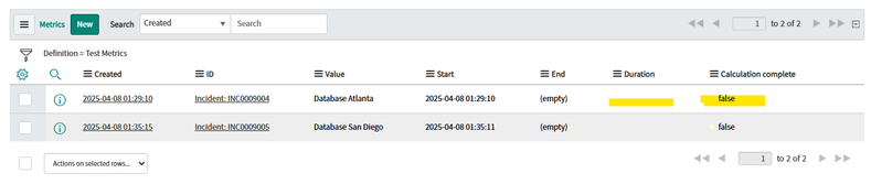

I have a requirement, where I have to create metric definition when incident is assigned to some specific groups where parent is ABC, I am able to add the condition and metric instances are getting created but when the assignment group is assigned to some other group or if assignment group is emptied the calculation is not completing and duration is not calculated, can someone help me on this? kindly refer below screen shots

Hi Shivalika,
Thanks for replying, I want to get the metric instances recorded for assignment groups where parent group is ABC, I am unable to dot walk and get this on report, so I have used condition in the script.
Hello @Bindhu1
Create a Database view between metric instance and incident table. Altering the metric definition is not required. I will try this out and share screenshot shortly.

Hello @Bindhu1
Thanks for marking it as helpful. Please accept solution as this is working as I have shown in the screenshots. This will help me be recognized for the efforts I put into solving this immediately and also assist future readers with similar queries.
