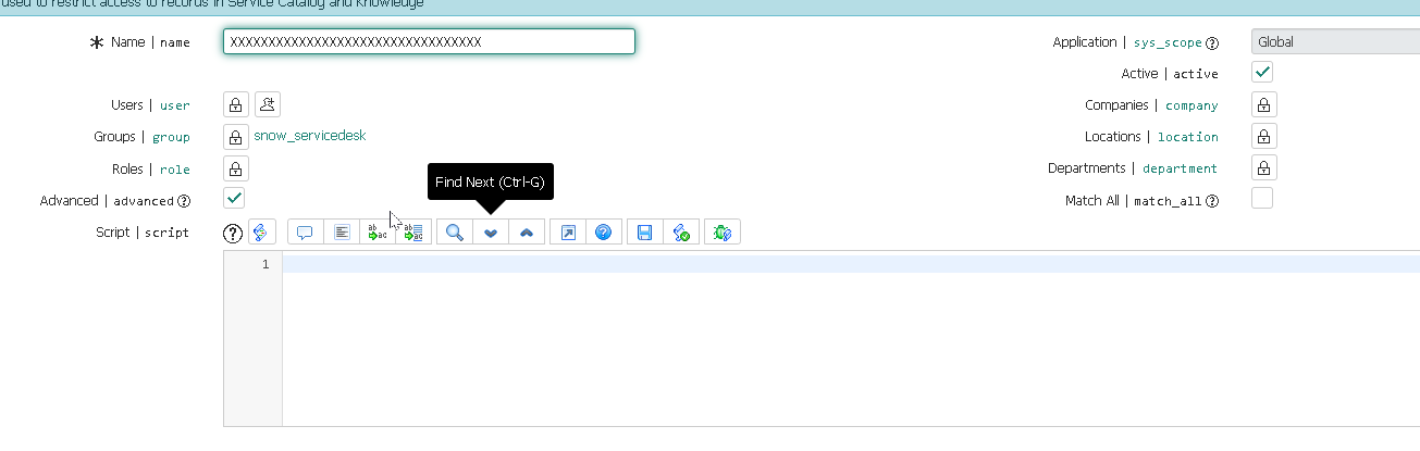

12-28-2020 08:51 AM
Ok,
I get your point. But, first - you can use the Cat item's User criteria (sc_cat_item_user_criteria_mtom table) to allow/not allow for one to see those (in your case by company I do believe). Or any condition you might seem fit.
Then just use same RefQual for the entire set - it's already filtered once. Also you can use script in the UC :
