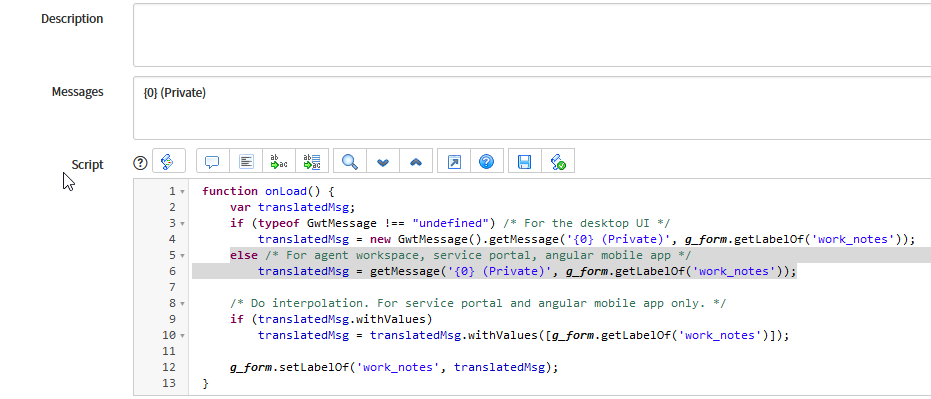

There is a Client script used for this:
Modify Work notes Label
yourinstance.service-now.com/nav_to.do?uri=sys_script_client.do?sys_id=24ac15175b123300ac18290291f91a4f
Here you can see the label is coming from translated message:
You can adjust the message by adjusting or adding a Message as follows:
(So leave the Key as is and change the Message. Do this for each language you have).
Another option is to change the Client script directly.
15 REPLIES 15
It should also work for agent workspace, as the script mentions:
else /* For agent workspace, service portal, angular mobile app */
        translatedMsg = getMessage('{0} (Private)', g_form.getLabelOf('work_notes'));
Which uses getMessage as well.
Have you tried clearing the cache for ServiceNow with cache.do in the Application navigator and clearing the browser cache?
I have found the Issue. The Client script is set to Isolate Script True.
If I change that to Isolate Script is False (unchecked) it works in Service Portal:
(note: Isolate script is per default not on the Client script form. You can add it to the form or list)
