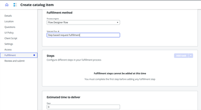

I am using catalog builder to create a catalog item but in the steps i could not see the estimated delivery time as a step in my PDI, can you please help me why it is not coming.But i can see it in the maintain wizard

Hi @kali
If you are using the out-of-the-box fulfillment flow "Step Based Request Fulfillment", you will be able to set estimated delivery time while creating your catalog.
‎06-03-2026 06:51 AM
Hi @JithinP
I am using catalog builder to create catalog items there is days variable on the fulfilment section when flow is selected as step based request fulfilment , how is days variable mapped to the delivery time in the backend catalog item table
