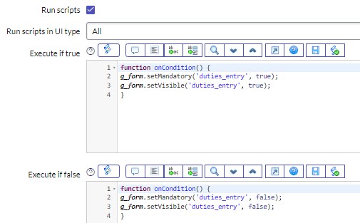

Respected Community,
When Selecting 'Task' (Choice) in Variable Field- Job Responsibilities, then only a Variable field- 'Task entry' becomes Mandatory & Visible.
*Outcome (Achieved but with Gap below)-
When Selecting 'Duties' (Choice) in Variable Field- Job Responsibilities, then only a Variable field- 'Duties entry' becomes Mandatory & Visible.
*Outcome (Achieved but with Gap)-
When Selecting 'Responsibilities' (Choice) in Variable Field- Job Responsibilities, then only a Variable field- 'Responsibilties entry' becomes Mandatory & Visible.
& When Selecting 'All' (Choice) in Variable Field- Job Responsibilities, then all three Variable fields- 'Task entry', 'Duties entry' & 'Responsibilties entry' becomes Mandatory & Visible.
*Outcome (Not Achieved as Duties Entry Missing, Sometimes its Visible & many times NOT)-
I tried to achieve this by UI Actions OR UI Scripts also, but not getting results, please help me with revise script or process, I will be thankful!

09-11-2022 07:17 AM
Hi
For the spacing issue, please use setDisplay() instead of setVisible().
Please mark the response as helpful/correct, if it answers your question.
Nikita

09-11-2022 07:56 AM
Hello Rishabh,
This is happening because you have I believe 3 UI policies and hence they are conflicting with each other. I would suggest you to create a single UI policy with the below condition:
Condtion: Job responsibility is one of Task, Duties, Responsibilities, All
In Execute if true: Please replace the correct field name and field Values (like All, Task, Duties backend value)
var jobResponsibility = g_form.getValue("job_responsibility");
if (jobResponsibilty == "All") {
g_form.setDisplay("task_entry", true);
g_form.setDisplay("duties_entry", true);
g_form.setDisplay("responsibilities_entry", true);
g_form.setMandatory("task_entry", true);
g_form.setMandatory("duties_entry", true);
g_form.setMandatory("responsibilities_entry", true);
} else if (jobResponsibility == "Task") {
// While hiding the fields you first need to set Mandatory as false and then set Display as false;
g_form.setMandatory("duties_entry", false);
g_form.setMandatory("responsibilities_entry", false);
g_form.setDisplay("duties_entry", false);
g_form.setDisplay("responsibilities_entry", false);
} else if (jobResponsibility == "Duties") {
g_form.setMandatory("task_entry", false);
g_form.setDisplay("task_entry", false);
} else if (jobResponsibility == "Responsibilities") {
in Execute if false:
Please mark my respsone as helpful/correct, if it answer your question.
