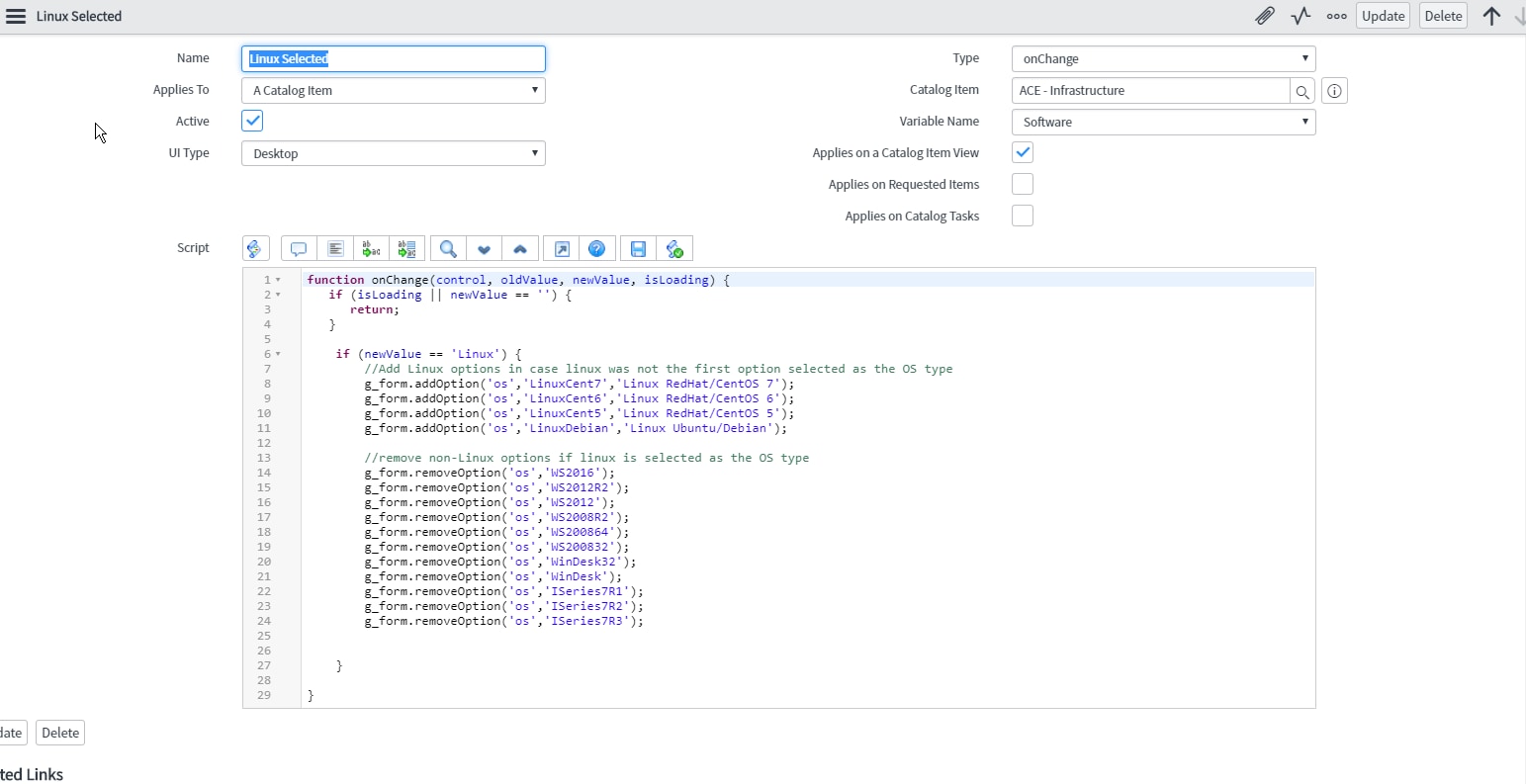

Hi Trudy,
Unfortunatly you will need a client script that manages the selection, it will get a bit complex because of the dynamic nature of the input. I would suggest you map this all out and define any static fields you can then leverage logic from. It is difficult to create a script with a dynamic input and have a dynamic output.
Here is a client script that we wrote, if you slect one, it will limit the aviable selection in the next variable:
11-02-2017 06:56 AM
I tried this up still getting same outcome when I make a change nothing happens. Perhaps I am putting my script in the wrong place? I was putting it in the Client Catalog scripts.
11-02-2017 07:34 AM
I would still like to figure out why I can't get the script to work as I think I will need something like this in the near future. I know it has to be user error, just need to figure out what I am doing wrong.
As always thank you for your time and efforts.
