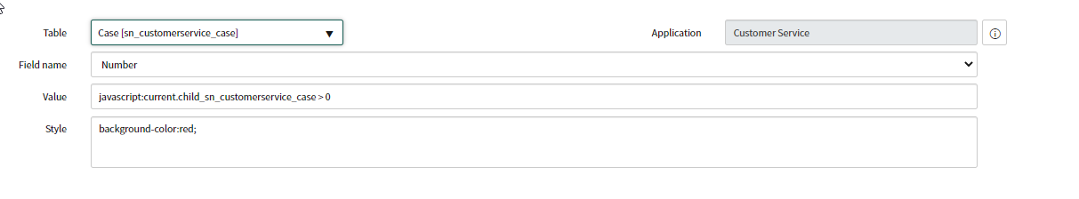

I am in the process of attempting to either add color coding or some verbiage/text that says "Parent Ticket", in the'Parent Incident' fields, within the incident list view...if the ticket is a Parent.
I've tried going to Field Styles and have tried a number of variations similar to:
Has anyone had any luck with adding field highlighting/color coding to the parent incident field, or perhaps some text?

Jim Coyne
It would make more sense to highlight the "Number" field because "Parent Incident" is only populated on the child and not the parent record:
Using the following Style:
Does it really worked by you out ? By me its failing
