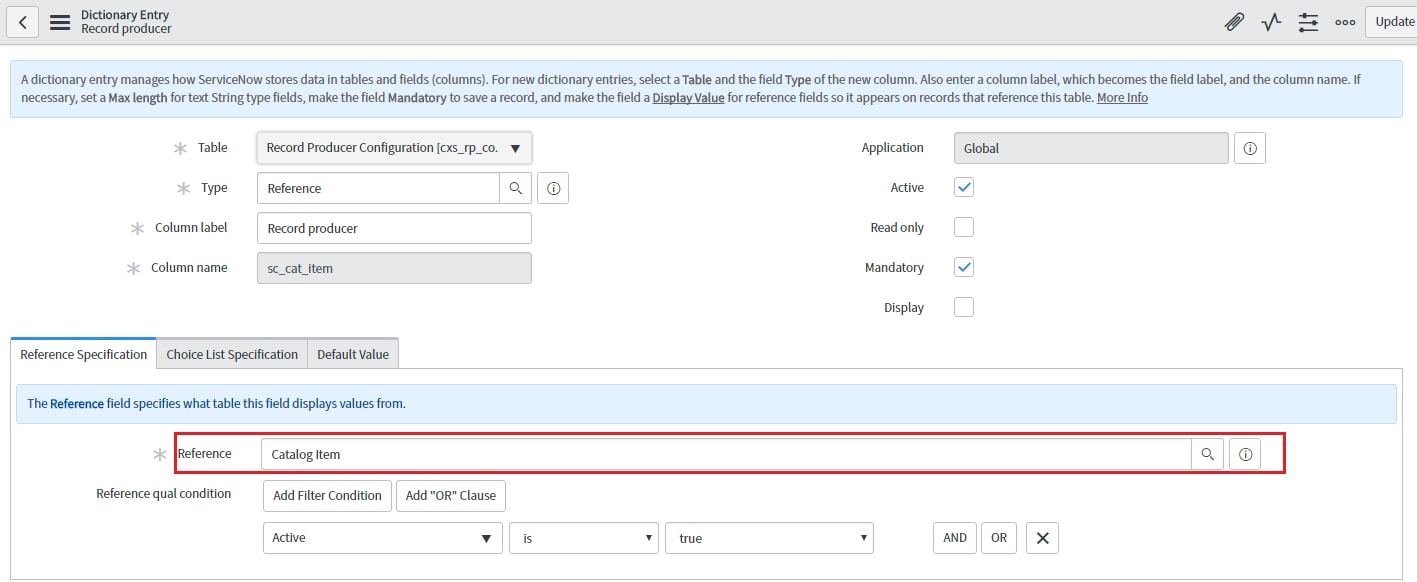

This feature is called Contextual search and is maintained under 'Search Context'. For this you need to follow the below steps:
1. Navigate to Contextual Search-->Search Context-->Open 'Incident Deflection'.
2. Under 'Record Producer Configuration' tab click on 'New' button-->Right Click on the field 'Record Producer'-->Go to 'Configure Dictionary'-->Under 'Reference Specification' tab change the field value of 'Reference' from 'Record Producer' to 'Catalog Item'-->Click Update. Please remember that this will change the field dictionary permanently.
