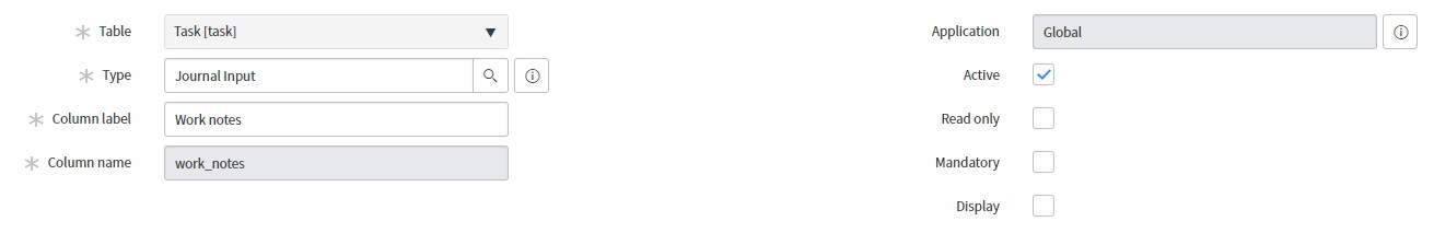

Anyways, you'd need to navigate to Dictionary > and search for Work Notes, which is essentially part of the Task table.
So you'd want to make a custom field on your new table that replicates this to an extent and type Journal Field which should come with it's own 'Post' button.

To start, you can right-click on the word: Work Notes and then go to dictionary to get a basic layout of what type of field it is.
From there, you'd need to basically replicate it (by creating a new dictionary entry on the respective table) to an extent and then add that to your form and ensure that the roles are defined properly as to who will see it.

Amazing that's done the trick, thank you so much
