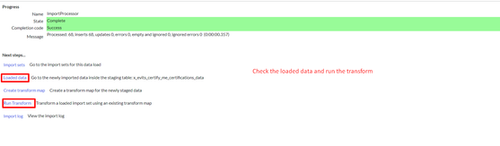

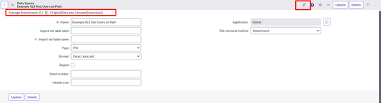

All you need is to remove the existing attachemnt & attach the new excel document and then 'Run the Transform' map by looking for 'Load all Records' related link.
