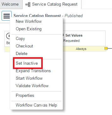

‎07-09-2019 12:53 PM
Is the other sc_request workflow still active? If you have two trying to run...they will conflict.
‎07-09-2019 01:12 PM
That is a good point. I checked earlier and the only active workflow I was able to find for the sc_request table was our modified workflow.
I was checking the wf_workflow table, is there somewhere else I should look to further check/confirm?
‎07-09-2019 01:24 PM
‎07-09-2019 01:29 PM
Yes. There are only the two workflows related to sc_request on the wf_workflow table. The OOB, which I have confirmed is inactive through the workflow editor, as you indicated, and the modified one that is active.
