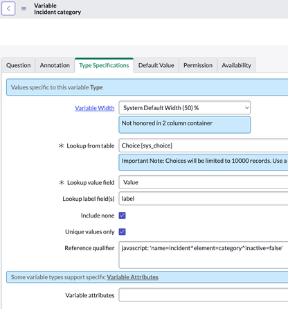

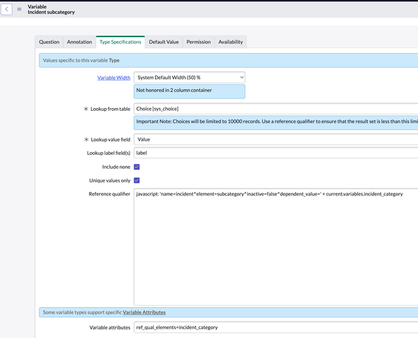

I have an issue that I'm fairly certain I've narrowed down to a dependent Lookup Select Box variable where the catalog item using it, not only takes upwards of a minute to load, but the task generated takes long enough to load that it routinely times out. The current setup is using a Lookup Select to Incident>Category as the dependent value with the dependent variable looking at the Choice [sys_choice] table for the subcategories. I've done a complete rebuild, with what should be a cleaner reference directly to Incidenr>Subcategory, but even that appears to be slowing load time of the Catalog Item (still around 30 seconds).
I have another setup like this on a different catalog item (using the cmdb_ci table) and it doesn't have any issues with response time.
Has anyone seen this type of issue before, and if so, how did you resolve it?

Hi Erik,
Can you clarify your setup of the category and subcategory variables?  Are you using the choice table for both?  A lookup on the incident table will slow down as the number of incident records increases.  I have a setup like this that runs pretty smoothly.

Thanks Brad, that totally took care of the delays on the item load and explains why there were delays. I'd initially gone to sys_choice on the rebuild but missed a piece of the reference qualifier which took me back to incident for both.
