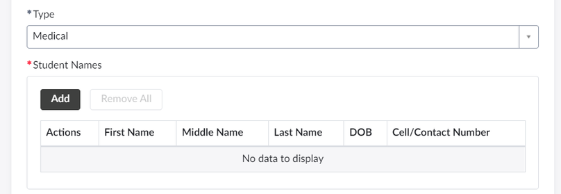

I got a requirement to display a variable inside the Mutli-row variable set when an option is selected from a variable which is present outside the variable set.
Below is my requirement:
If the drop-down value "Medical" is selected from the variable "Type", then another variable "Medical Student Year" need to be visible inside the Multi-row variable set (After the "Cell/Contact Number" variable).
Please let me know if anyone has worked on this and find the solution.

Hi @maroon_byte ,
Thank you so much for your reply. I tried the solution provided by you and its not working.
I want "Medical Student Year" variable to be visible inside the MRVS when the drop-down value "Medical" is selected from the variable "Type" that is present outside the MRVS.
Is there a way to implement this by onChange client script?
