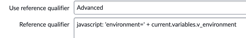

02-04-2026 10:20 AM
For a 100% human (and correct) response, if you are using the out of box field named 'environment' extended from the cmdb_ci table to track which servers are used in which environment, the choice values are 'Development', 'Test', and 'Production'. If these are the values in your instance your Catalog Item variable choice values should be exactly the same (you can display Dev, Test, Prod if you really want to as long as the value of the choices exactly match).
Then, all you need to do is set the reference qualifier on the reference variable to something like this:
where 'v_environment' is the name of the select box variable.
If the reference variable is in a multi-row variable set, and the select box variable is not, that's a different issue, but since you didn't specify I'm assuming for now that it is in a single row variable set.
