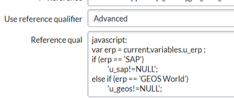

11-24-2023 01:13 AM - edited 11-24-2023 01:15 AM
Hi Nagashree,
Can you try below:
javascript:
var erp = current.variables.u_erp;
if (erp == 'SAP')
'u_sap!=NULL';
else if (erp == 'GEOS')
'u_geos!=NULL';
Please mark this answer as correct and helpful if it solves your issue.
Siva Jyothi M.
