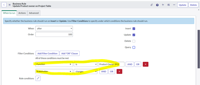

01-25-2024 11:58 PM
Hi @Jeck Manalo
Okh got it...!!
You can write Business rule on 'pm_m2m_project_stakeholder' table with condition
Script :
/*1. Get the value of project */
var getProject = current.getValue('project'); //will get sys_id of project record
/*2. Get value of Stakeholder */
var getStakeholder = current.getValue('stakeholder');
/*3.Glide record on Project table */
var grProject = new GlideRecord('pm_project');
grProject.addQuery('sys_id',getProject);
grProject.query();
if(grProject.next()){
/* 3.1 Update product owner with stakeholder */
grProject.setValue('u_product_owner',getStakeholder);
grProject.update();
/* you can improve your code as per your need */
})(current, previous);
**Note : This will run for new records or if it gets updated.
For existing record you can do it with fix script.
Hope this helps...!!
ServiceNow Developer
- Socrates
