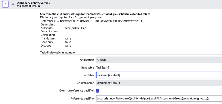

Error Messagejava.sql.BatchUpdateException: (conn=284652) Duplicate entry 'incident-assignment_group
Nitish16
what I am trying is in Incident table which is the child table of Task table, in assignment_group column trying to Override reference qualifier and adding the active=true^EQ
so that assignment_group  will reflect only active groups and that change should happen in the Incident table only which is child table, but it is throwing error as above

What does your new reference qualifier look like?

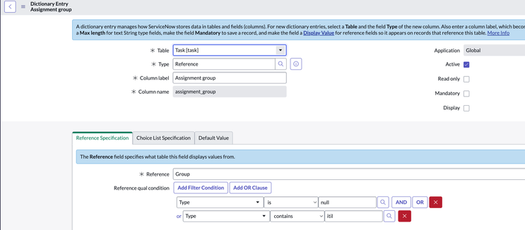

To clarify, are you changing this on the dictionary entry - so on the task table:
Or on a new or existing dictionary override for the incident table?
@Nitish16 Yep, that's correct. You can't have more than one Dictionary Override for the same table and field. I wish I could mark your message as the correct answer.
existing dictionary override for the incident table.
