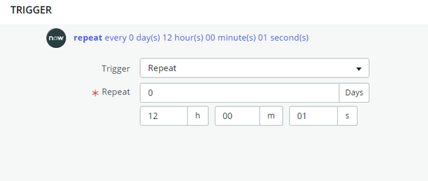

I created a flow with the following trigger condition
My goal is to run this flow at midnight and midday every days. But it is not running on this schedule.
My question is: At what system time will this condition be true? The condition is every 12 hours, but which time is it based on?

@Andr_1 It is based on the time when you activate the flow. The flow will run 12 hours from the time it was activated.

@Sandeep Rajput I want it to run every days at midday and midnight. How can I achieve this?
@Andr_1 Try activating the flow during Mid day and it will run every 12 hours from then onwards.
@Sandeep RajputThis doesn't seem like an effective way later for maintenance
Could I create a new schedule job and run the flow by script?
