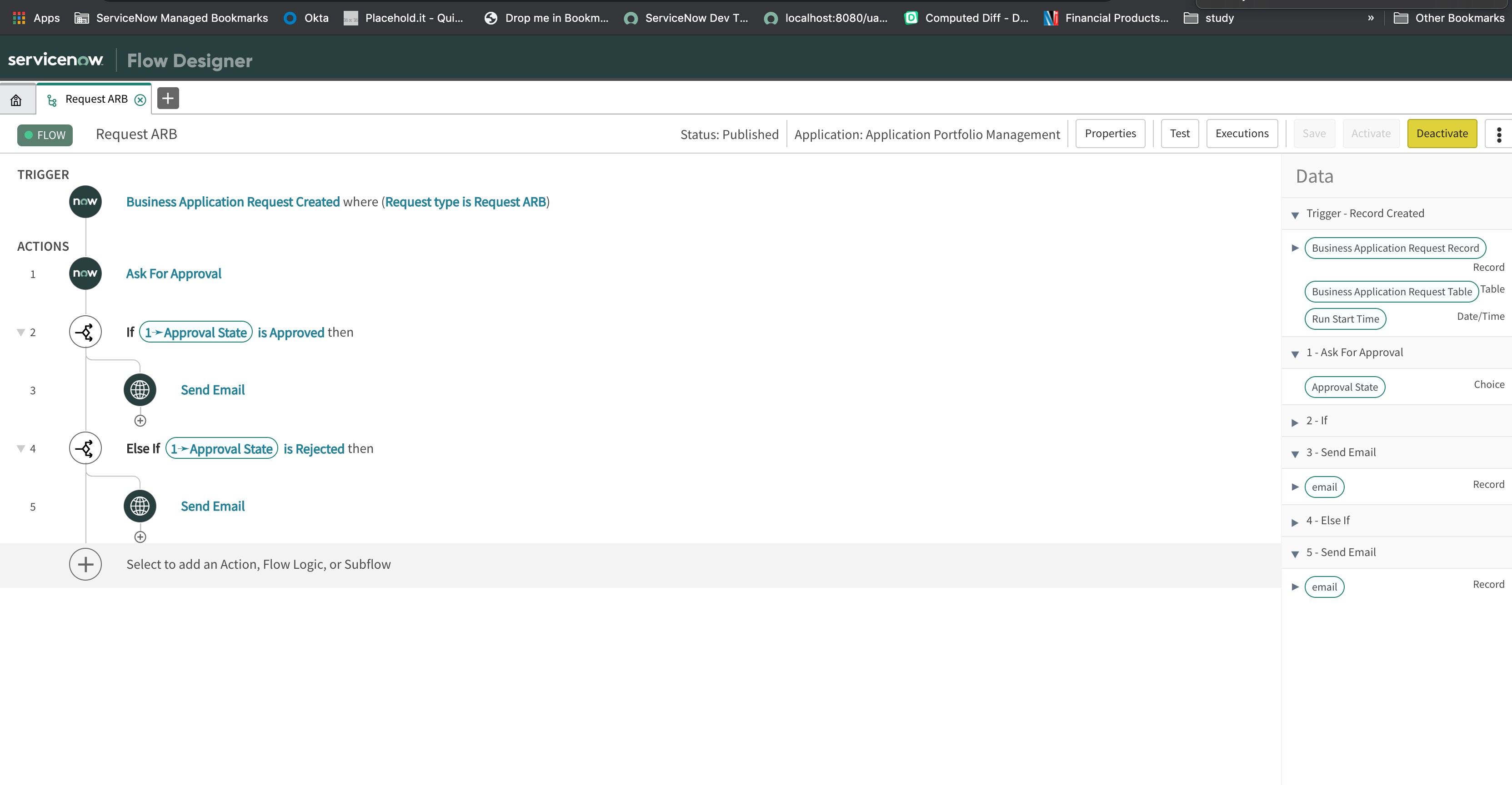

can you add more details about your flow designer ?
if possible add some screenshot,
just confirming have you added any subflow ? or its just normal  flow designer like below screenshot ?
There are no sub flows. Attaching the flow
