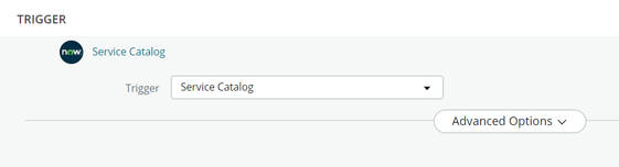

as always: screenshots would be really helpful, as it is not clear what you mean with "I am trying to associate it with the request table".
Therefore I guess you want to create a trigger for created/updated records on table sc_request, correct?
If so, this is not possible. Instead, you have to use the "Service Catalog" trigger:
Maik
This was where I was going wrong - thanks for the help!
