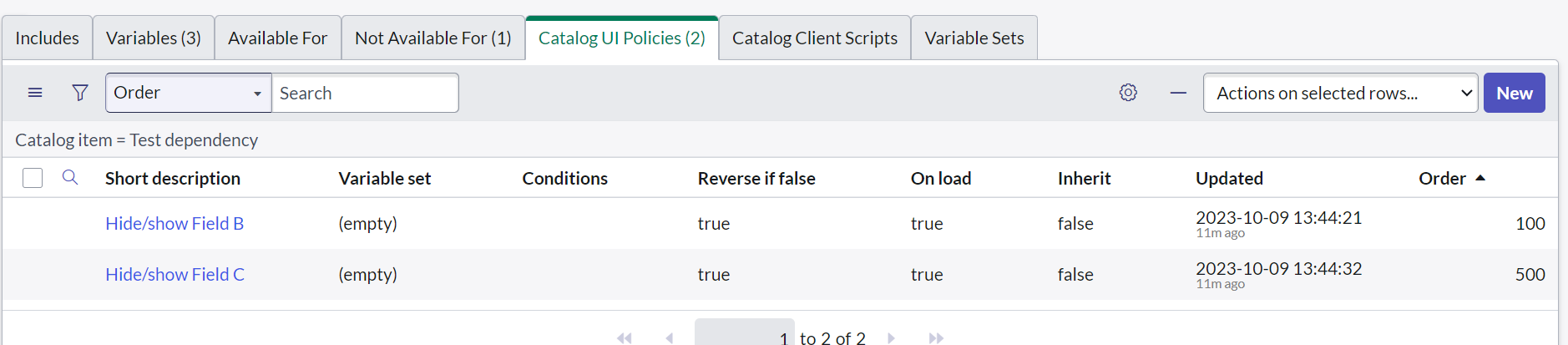

UI policy #1 - Hide/show Field B
UI policy #2 - Hide/show Field C
In catalog item
1)
2)

UI policy #1 was not well thought out because I was clearing the value of the B field only when the value of A was being set to X. Instead of this, what I needed was to clear this value when A was not X. By doing this, when I change the value of A to Y or Z, the value of B gets cleared out, which then triggers the second UI policy that hides C because B is no longer X.
In catalog item
1)
2)
