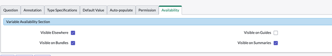

I just realized that probably doesn't make sense if you don't have the variable/set on the OG.  In the variable set in the Catalog Item you can uncheck the 'Visible on Guides' box so that the variable does not appear when the Catalog Item is spawned from an Order Guide

The variable is in a variable set which is used in the catalog item. I appreciate your help and will check the ui policy on order guide!
Perfect that did it. After so many years working with ServiceNow I never used or knew this 🙄
